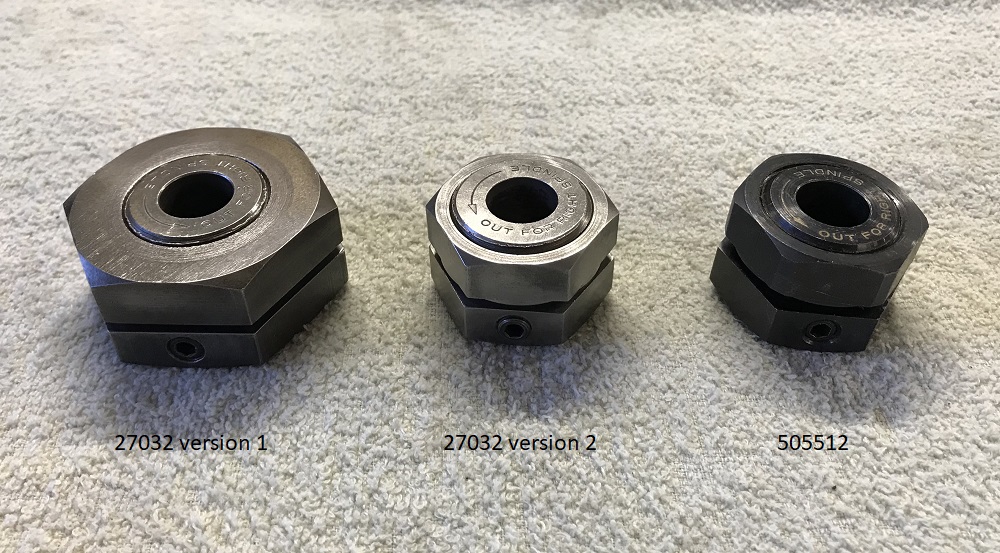

Posts: 3488
Re: Arbors
Nipper10,
Do you have a Sawsmith Radial Arm Saw? The 1-1/4" Arbor P/N 27032 and 505512 were made for use only on the Sawsmith RAS. There were two versions plus a third one with the black protective coating (505512). The Part Numbers for all Shopsmith items changed in 1964. At the same time the black protective coating was added to parts. 505512 is the same as 27032 version 2 with the black protective coating and new part number. The picture below is for your reference.
27032 and 505512 labeled.jpg (277.04 KiB) Viewed 9153 times
Sorry I do not have an extra one of either version of P/N 27032.
