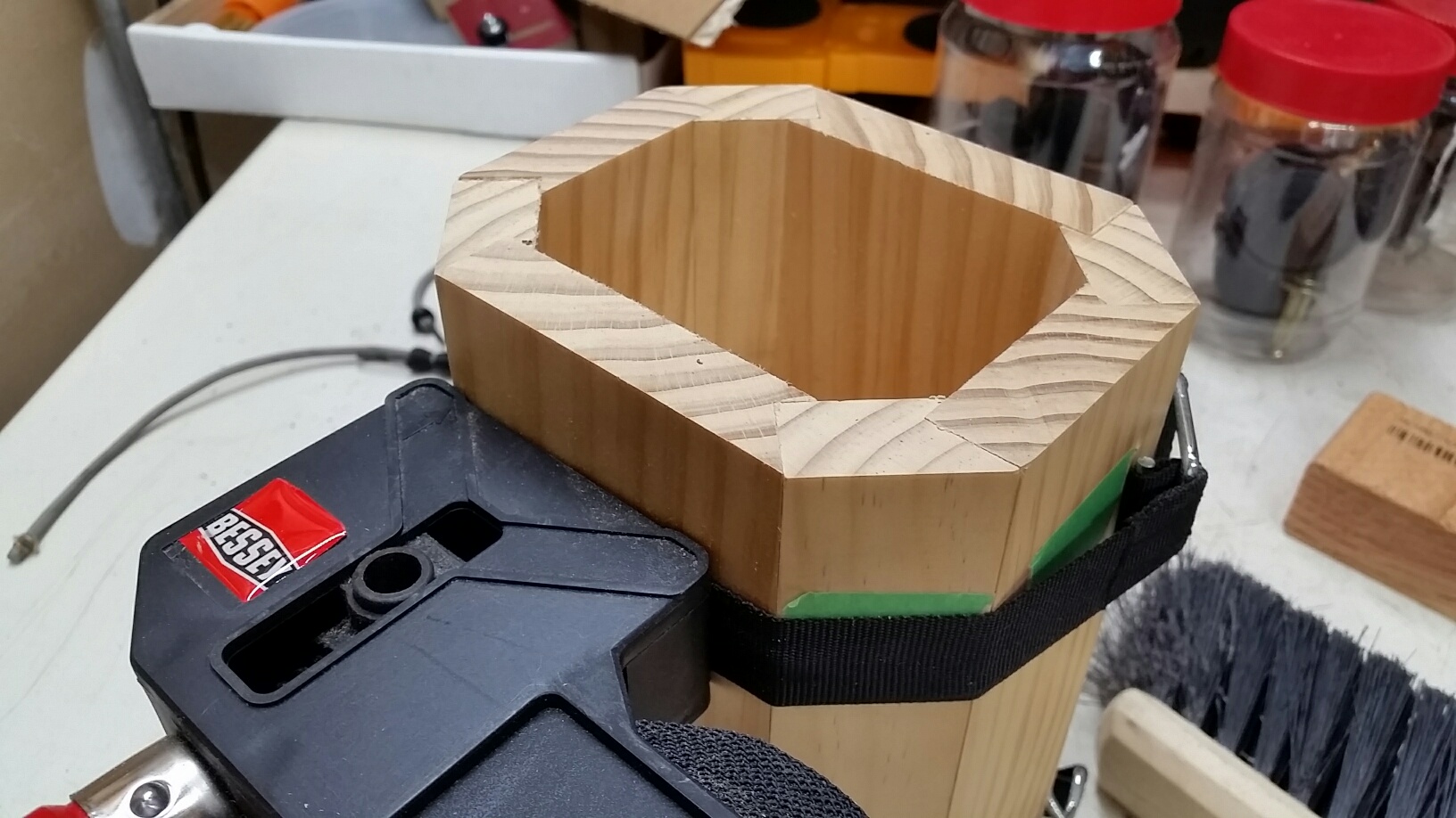

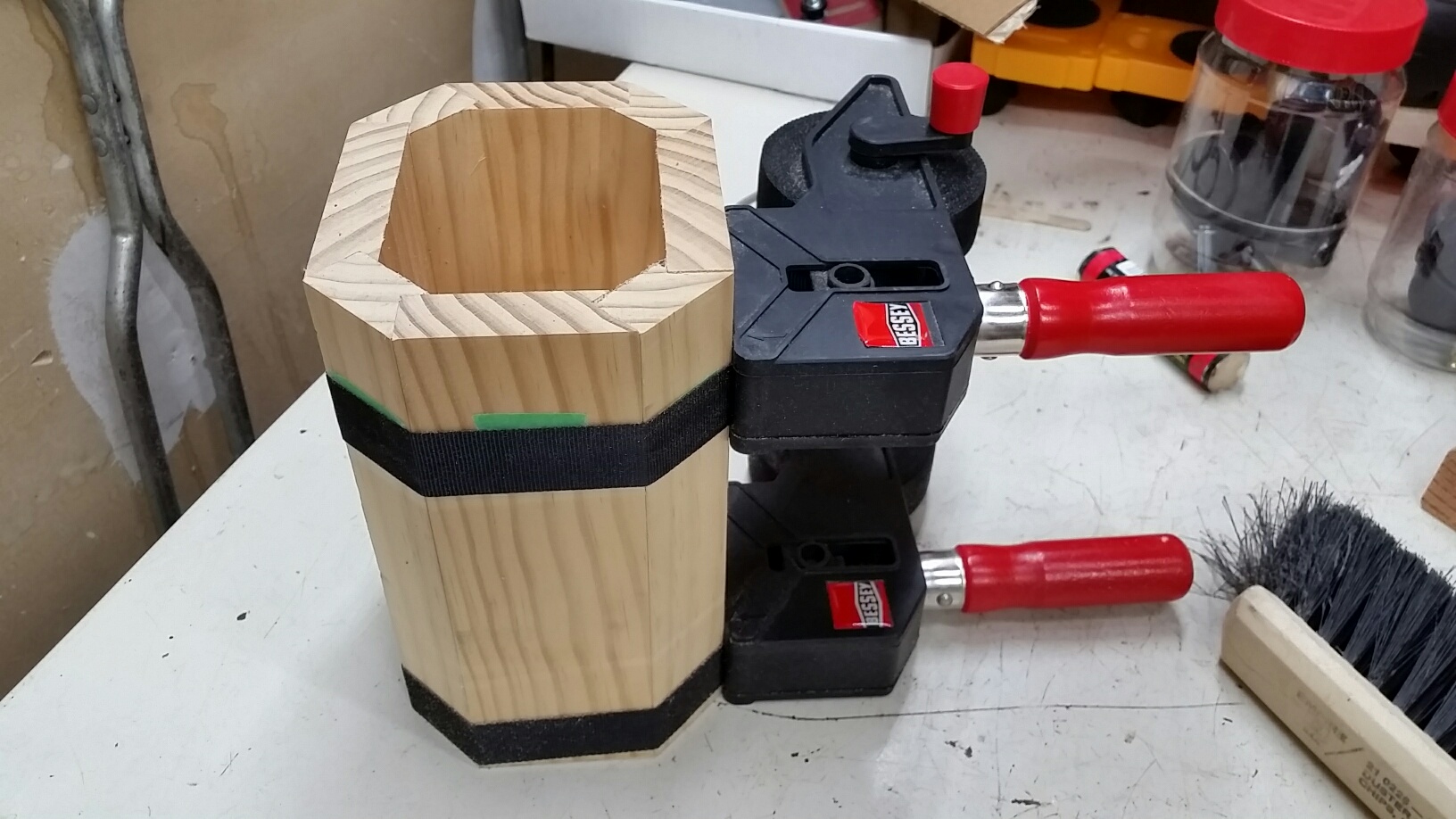

They sell banding clamps made of webbing that work pretty well. A lot depends on how many and how big the boxes are. Another idea you may want to consider is splining the joints using a saw blade. It is a very simple jig and the SS does it very well. It will make assembly much quicker and infinitely stronger. The jig takes about 15 min to make. We can walk you through the building of the jig if you are interested in using that method.

This is a wren house and it is ready for glue but I just haven't got back on it. I see it picked up a few dents and scrapes in storage but it is a bird house so....... I have these band clamps that it is held together with and with the joints it just pulls together. It also helps that I made a inset bottom that also helps to hold things together.

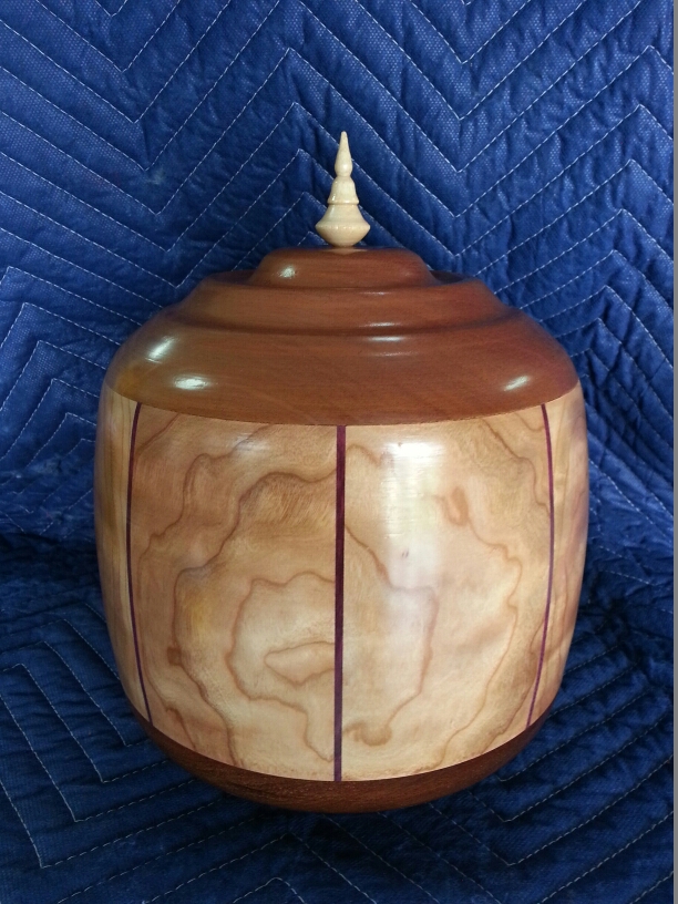

OK so here is a burial urn that I made for someone ( not the person in the vessel ) a few years back.The sides (cherry) were cut on the table saw function with the table set at 30 deg. The highlight stripes were thin cuts of purple heart. These cuts were side grain to side grain when the vessel was glued up. I used large automotive hose clamps connected back to back so as to have enough length to go around.
If you are contemplating a 4 or 6" deep box then the sides can be cross cut from a 4 or 6" wide board and this will cause end grain gluing but sufficient strength should be provided when the box bottom is added.

The urn is beautiful. I hope I can build something that nice. Looks like hose clamps will work. I have done some segmented turning and they seem to work pretty well. I will probably use one on the bottom and one on the top. I wont have any problem with strength if I can get box joints at the proper angle. It is just a matter of experimenting. Thanks for the help. Larry
