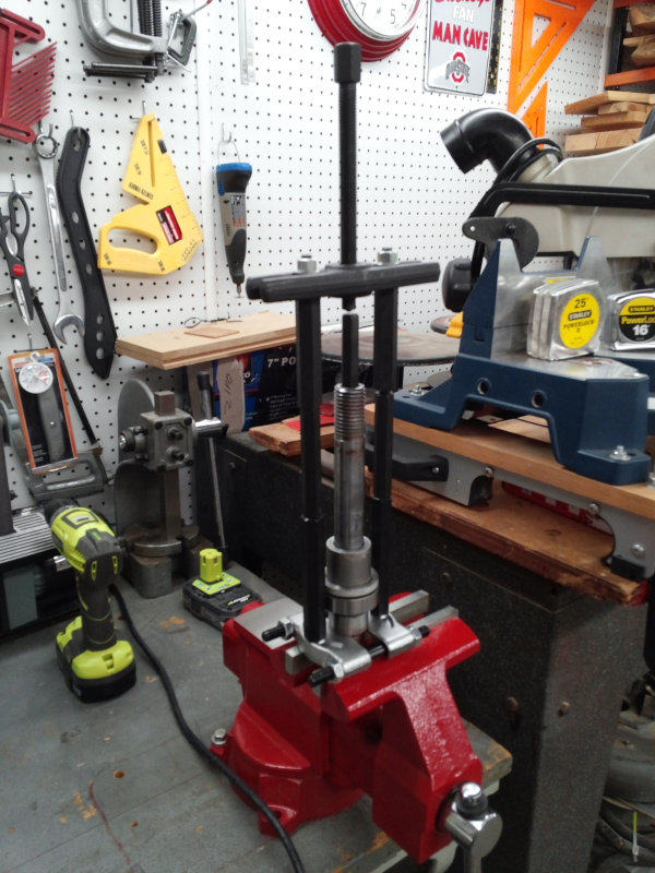

This morning, I conquered what I hope will be the last serious rebuild challenge for this old lathe -- that spur drive in the spindle was stuck in an absolute death grip. The photo below shows my setup from an early removal attempt -- not shown is the large handscrew clamp that I used as a torque restraint for the HF bearing splitter. The final bearing-splitter attempt came after a week-long soak in Evaporust. It did put a dimple in the back end of the (American made!) drift punch that I was using as a ram, but the spur drive didn't budge.

At this point, I decided that finesse wasn't the answer, and escalated to what I'll politely call "the BFH method". First, I ginned up some fixtures for driving out the spur drive, with the goal of zero damage to the spindle. A short piece of 1" black pipe was perfect to support the front spindle flange, an a 12" length of 1/2" steel bar (both from HD) made a sturdy knockout rod. I ground the ends of both pieces nice and flat with a Shopsmith disc sander. Finally, I cut a small length of 1" dowel to cushion the spur drive when it (hopefully) blasts free. If this doesn't work, the spur drive will have to be machined out of the spindle, and the Morse taper re-cut.

And using the end of an ash log to take the pounding, we have success! As you can see, the problem with the Evaporust soak was that it couldn't penetrate very far into the taper.
Tool abuse.JPG (462.19 KiB) Viewed 12322 times
I had resigned myself to buying a #2MT reamer and cleaning up a damaged spindle taper, but amazingly, the taper itself appears to be unscathed. The abusive PO had beaten the crap out of the back end of the spur-drive taper, though, mushrooming it considerably. The inboard spindle threads were not as badly battered as outboard ones were, so they should clean up nicely as well.

Awesome! I love it.
In my rust-hunting, I've several times found that impulse-strikes can do what continuous force cannot do.
