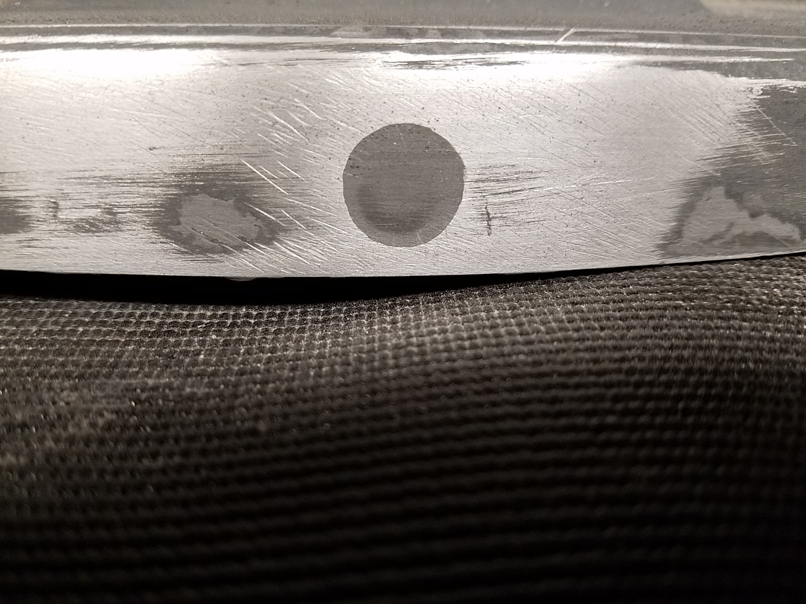

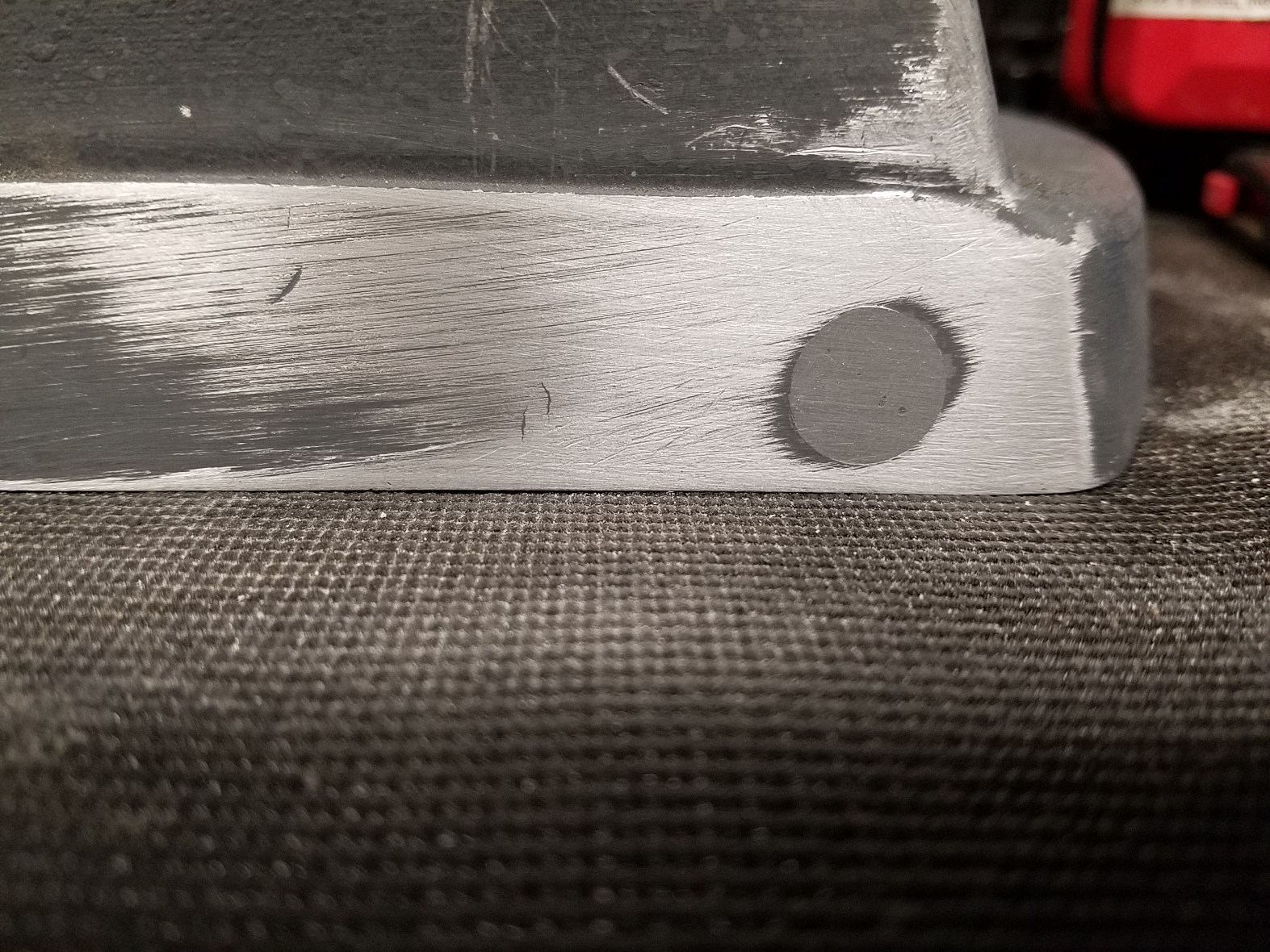

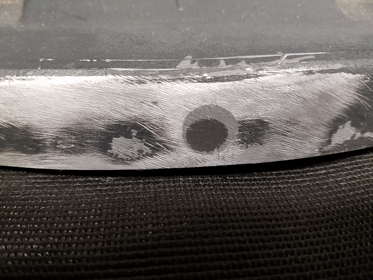

Posts: 21371
Re: Repairing Model 510 Castings, A Question
Thanks for the advise; however, I choose to do it my way.
It is too early to say that it works. It is even too early to say that I am done but a couple holes are nearly ready for paint. Just some prep work remaining.
I learned a couple things. Mix well and don't over fill. Also, JB Weld is self leveling.
