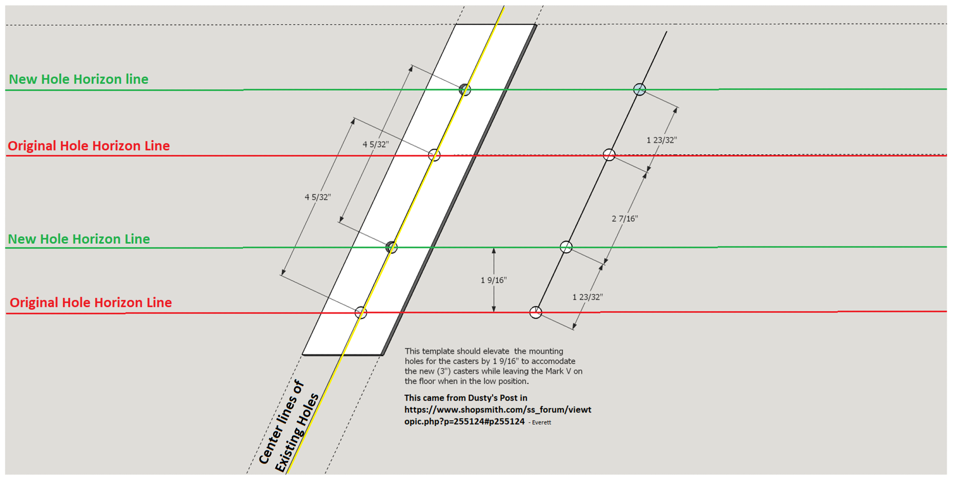

Now that folks have had a chance to view this in text only format, for those who need visual references I used a modified drawing that Dusty did in post https://www.shopsmith.com/ss_forum/view ... 24#p255124
I added the red lines (original holes) and green lines (new holes) and yellow line that intersects center-line of both original holes and establishes the point on the line for the new horizon lines.
As I said in 2nd post You must do this on a level floor to start with, and accordingly, the horizon lines must be level, parallel to the floor.
Dusty discussed that he had done 3 Mark V's with this setup and the distance as you can see between original and new horizon lines was 1 9/16" exact center-line to center-line, [yours may be that] which allowed his base ends for the bench to rest on the floor in the fully retracted position.
Read through that whole thread. Know what you have to work with before you do anything.
Everett
