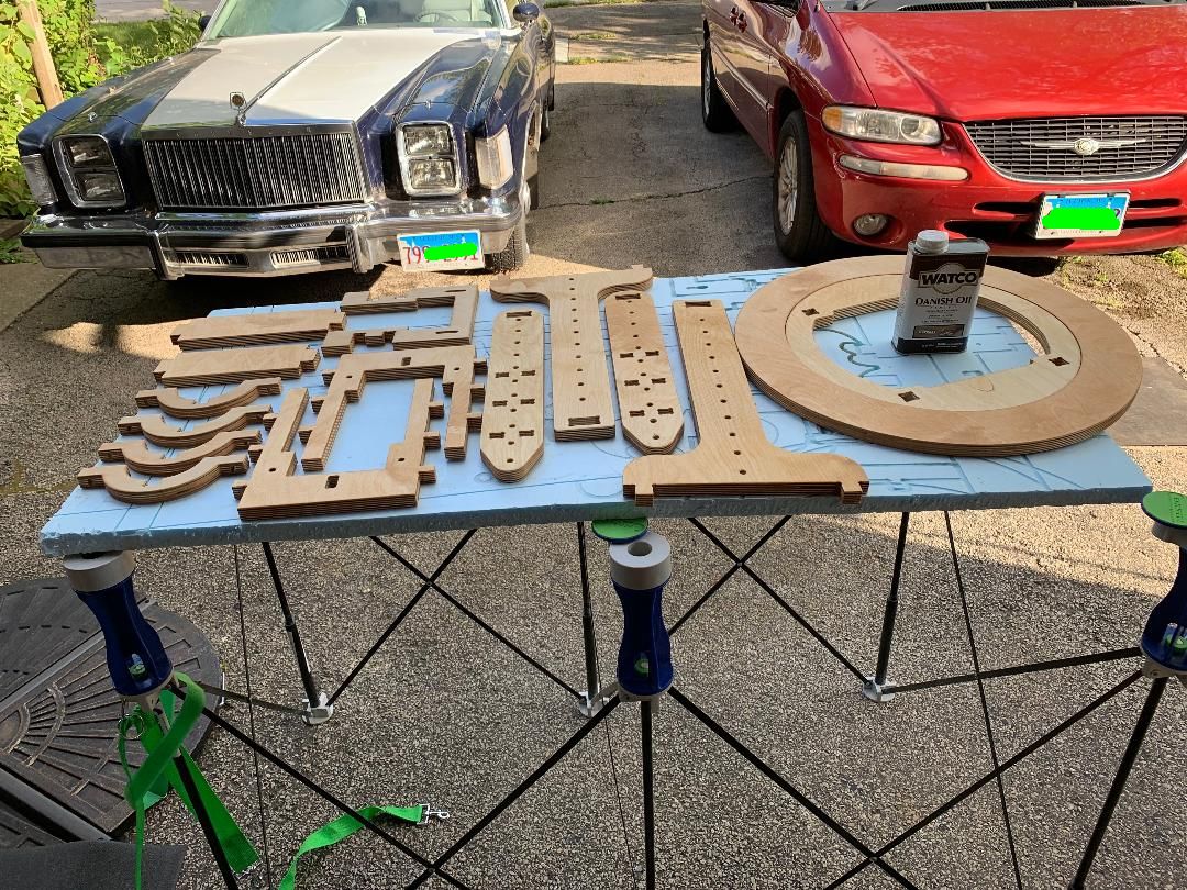

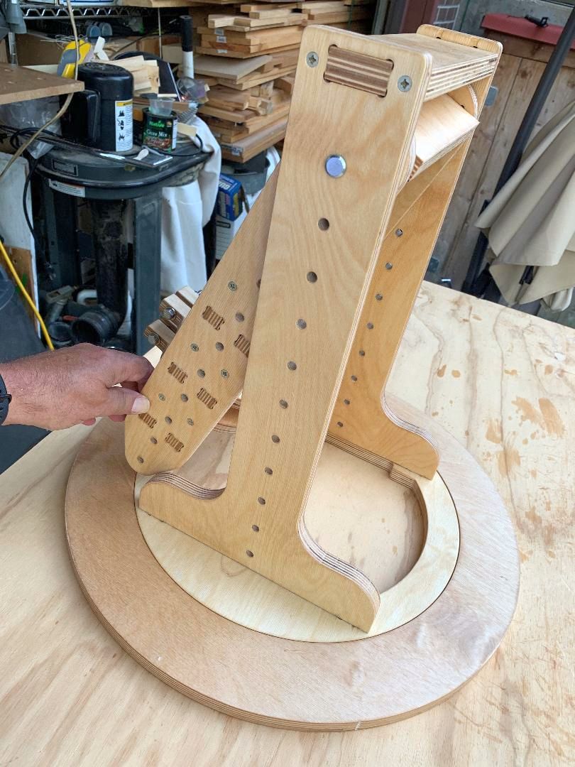

More progress. I sanded with 80 then 120 grit and had to get the base pieces to play nice together, rotation is needed and it was sticking so perhaps a bit out of round or just not enough space?? Anyway it is working now and that is what counts.
I finished with two coats of Watco and it is now in its final drying cycle. Tomorrow afternoon I hope to put it together again and this time add the screws. I still have not attempted to fit the router so that will be one of the next things to do, assuming I have the correct screws on hand this shouldn't be a problem.
After that it should be ready for a test.
Want to play with a little before I attempt a project, use up some scrap wood for that.
watco drying.jpg (288.26 KiB) Viewed 31237 times

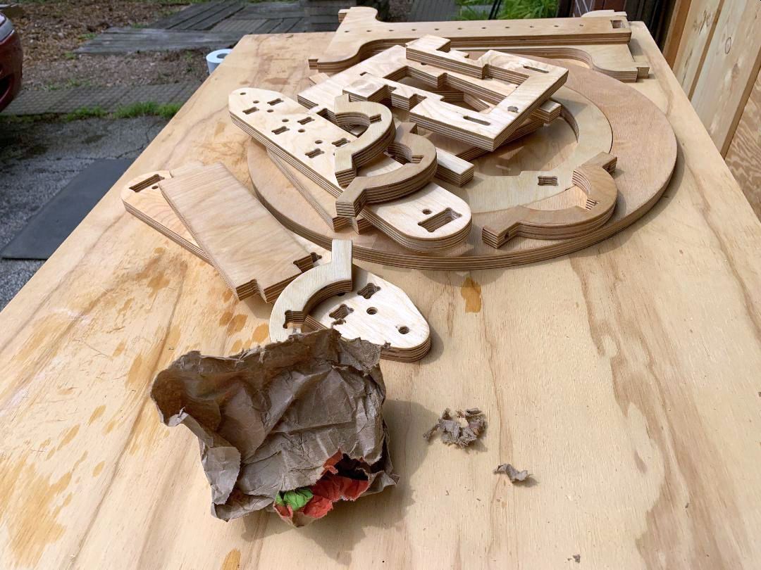

More progress but no cutting yet.
I used the brown paper bag sanding method to smooth the surface up a bit. In this case a bag from BK that my last Whopper came in.
brown paper bag sanding.jpg (150.35 KiB) Viewed 31185 times

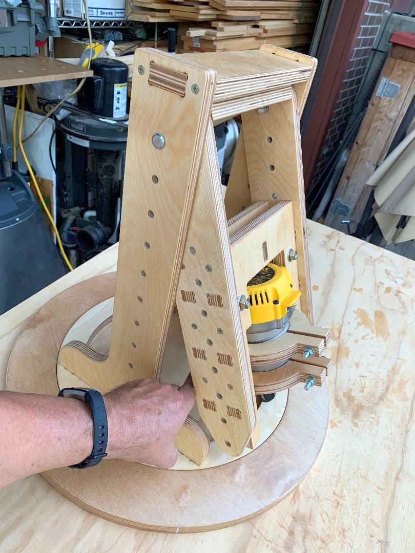

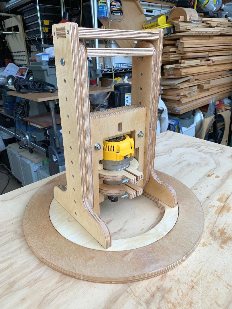

Drilled the screw holes and did the countersinks then put it together. Time for another test fit and found a small amount of rubbing in the swing arm. The top tenon on both sides was a fraction too long. Just sanded it off and then added another two coats of finish to that area. Had to let it set for a while to dry.
I got out the router because that is one of the parts of the assembly that I had not tried. Glad to say it fits fine. So it was time for a little paste wax and did two coats with a rub off between and after.
It is pretty much ready for a test run but I was running out of day so put it off until tomorrow.
swing it to the right.jpg (151.63 KiB) Viewed 31185 times
swing it to the left.jpg (144.7 KiB) Viewed 31185 times

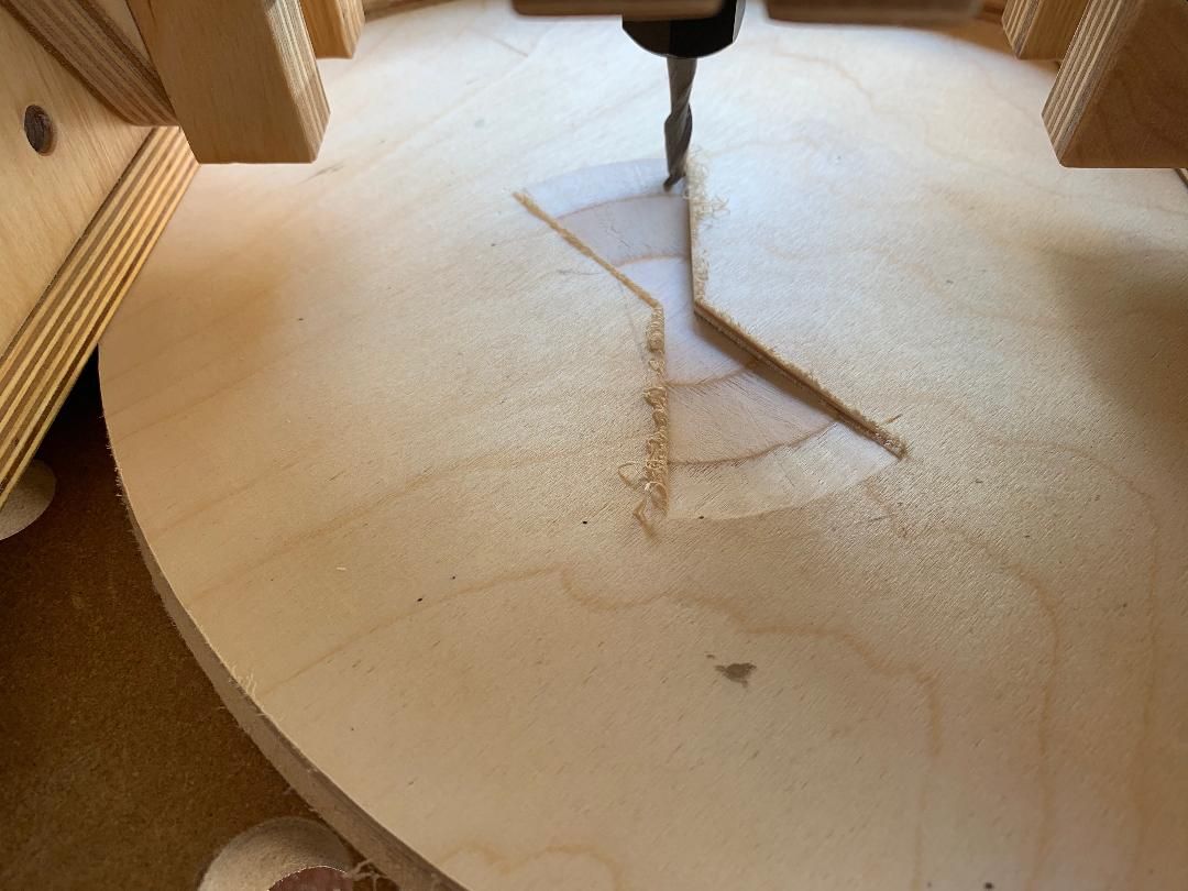

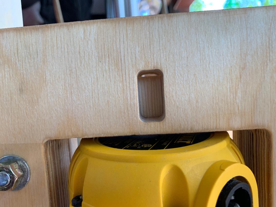

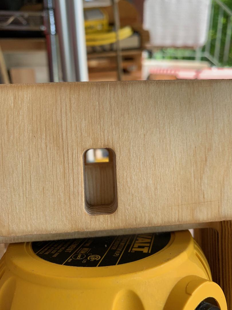

And the long awaited post where I show how this works....... well for some of you anyway.

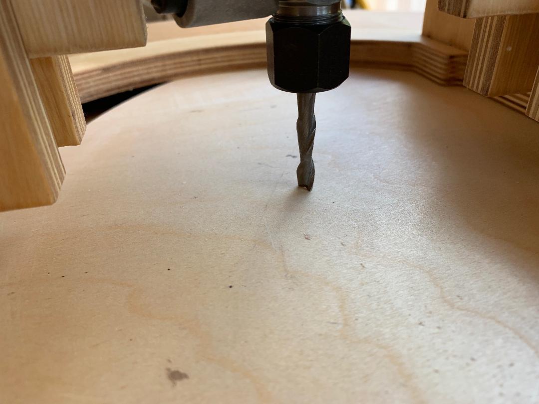

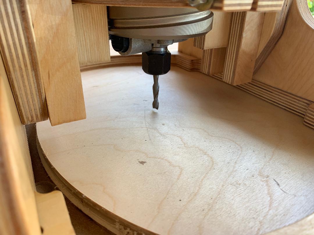

I used a 1/4" spiral bit for today's explore. The bit is just clear of the work piece when installed in this case. Different bits and different amounts of insertion of course determines this.
In this photo you can see the bit above the work surface.
The built in view port looks like this at this point in time:
You can then adjust the bit to just touch the surface or zero it.
p zeroed.jpg (80.97 KiB) Viewed 31048 times
In my case I want to play with a very shallow dish cut. I don't recall if this was at cutting depth or a zero but anyway you get the idea I hope.
p viewport.jpg (104.19 KiB) Viewed 31048 times
And now before you look at the next picture you can ask Alexa to do a drum roll if you wish:
More later today.
Re: I know what I want to build yet this year!

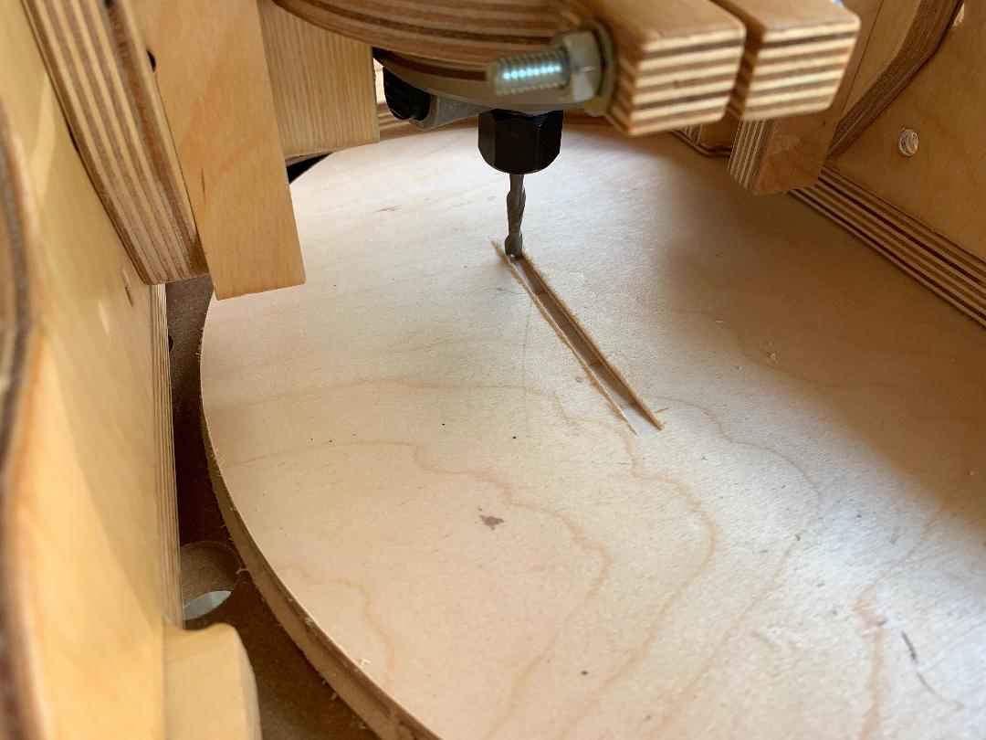

The general idea is to swing and rotate. While it works with the set up I was using you do end up doing a climb cut on half of the cut. You could do half cuts and not have this but it will be slower.
p progress.jpg (101.53 KiB) Viewed 31029 times

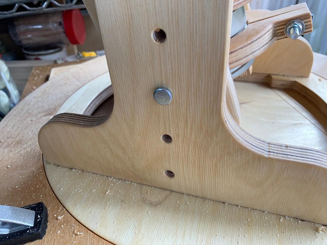

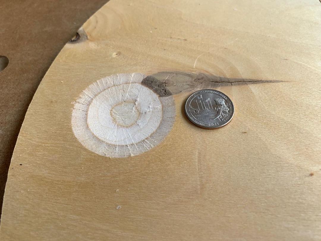

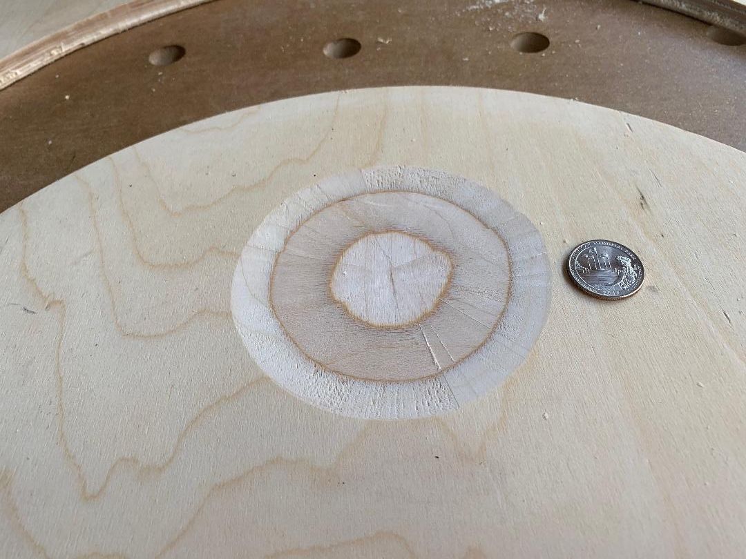

I did two radius cuts, one with the machine set to max, ie as high as it will go and then a second set in the third hole from the bottom.
p pin location.jpg (122.29 KiB) Viewed 31029 times
Keep in mind the deeper you cut the larger circle that will form. Cutting as shallow as I was you can see the difference caused by the different radius in the next two photos
p smallest dish.jpg (132.77 KiB) Viewed 31029 times
p small dish.jpg (126.77 KiB) Viewed 31029 times
I think some sort of dust deflector or collector would be a nice addition along with some sort of handle near the router for better control.
