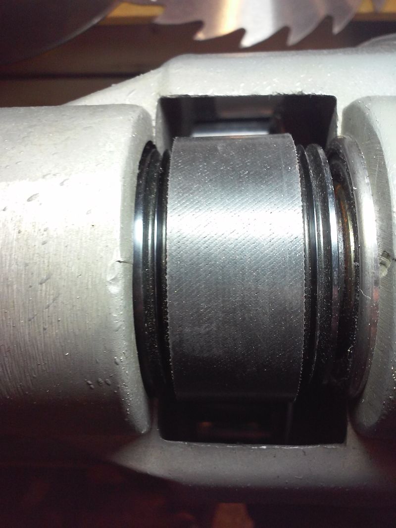

There is some disagreement regarding the correct groove location of the poly-v belt on the drive sleeve pulley. The positioning of the idler sheave can affect it. The goal is to not have the poly-v belt twisting to align with the drive sleeve pulley grooves as it runs.

First the Poly V from above. I count two grooves on the left and two on the right. Right side is towards the switch same orientation as the video.
Poly V from the top - two grooves on both right and left

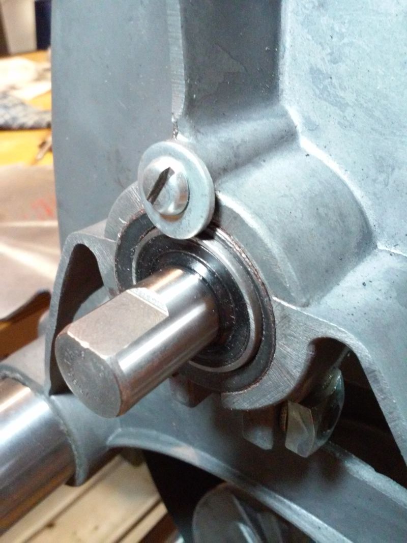

The idler showing how much of the bearing is protruding. Washer is tight but there is a bit of a shelf. Setscrew is not doing anything, point is gone. This is the oversized washer that I now understand I do not need. Once I get the screw installed and the bearing positioned correctly.

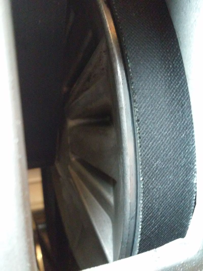

Showing amount of belt sticking out past edge of Control Sheave in Slow position. Is this too much?

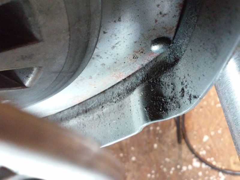

A little dust from my new belt... Have ran the machine for short periods of time, probably OK but???

In the second image (showing the bearing, washer and screw), the bearing is protruding further than it should. The washer is intended to prevent the bearing from doing what you see there. The idler shaft needs to be relocated.

dusty wrote:In the second image (showing the bearing, washer and screw), the bearing is protruding further than it should. The washer is intended to prevent the bearing from doing what you see there. The idler shaft needs to be relocated.
Reference my earlier post.
That is NOT normal.
Perform a high speed adjustment. I suspect the control sheave is hitting the speed control leg. Or thje control sheave is missung the bearing.clip etc..

The rubber dust is interesting. You said that you worked on the sheaves where the belt rides. Are the edges of the contact surface of the sheaves sharp? You may want to take the sharp edges off them so the belt doesn't wear prematurely. Also check for a slightly bent sheave. You may have to turn the spindle by hand while watching the edge of the sheave to see any movement. Is the floating sheave on the motor moving smoothly. I have found that the motor shaft and the control sheave shaft should be polished as smooth as possible to provide easy movement. Also when you tighten the bolt under the eccentric, only enough to flatten the lock washer. Over tightening the bolt can crack one of the wings off the casting. DISASTER!!!

Ok yeah, I need to look at this. It may be the cause. I may have damaged the motor sheave trying to get it unstuck. I was using a rubber mallet. I hope not because that means I have to take that spring off again ;) It would explain the the sort of low pitch vibrational noise and it would also make sense that I heard it from the beggining. I worked on freeing that sheave before I ever applied power to the machine. I spent a long time on the motor sheave polishing it smooth, the control shaft was in better shape to begin with but I did them both. The sheaves glide back and forth.
I am suspecting the outer motor sheave might be bent. That's the next place I am looking. I could take the belt off and see that easy enough...
