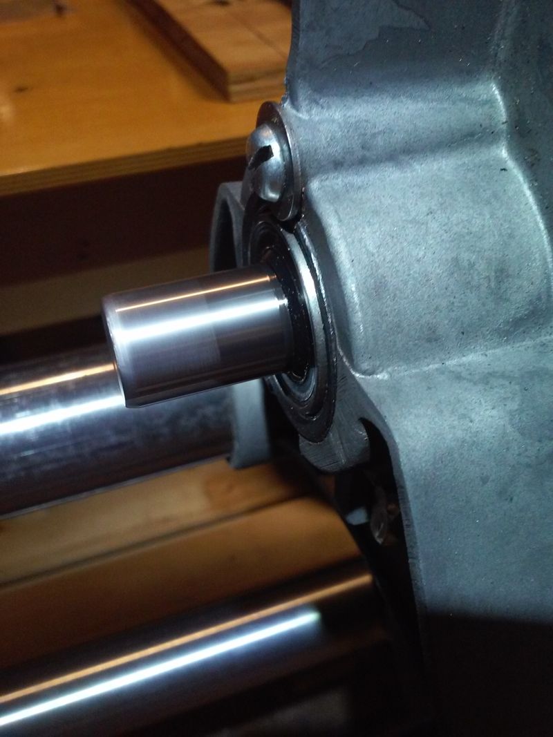

dusty wrote:In the second image (showing the bearing, washer and screw), the bearing is protruding further than it should. The washer is intended to prevent the bearing from doing what you see there. The idler shaft needs to be relocated.
Reference my earlier post.
That is NOT normal.
Perform a high speed adjustment. I suspect the control sheave is hitting the speed control leg. Or thje control sheave is missung the bearing.clip etc..
A pix of the interior will help.
Yes thank you both for the input,
I agree the idler is not positioned correctly - nor the eccentric. I think when I get the set screw I will... Make the eccentric face flush with the original washer. The cone point set screw should hold the idler bearing and shaft in the exact right position with in the eccentric.
