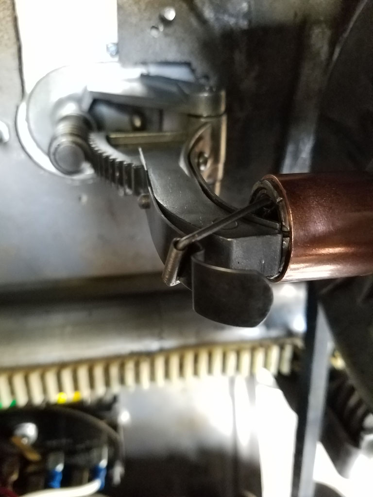

I have learned a lot about my Mark VII over the last several months, and I still have a LOT yet to learn.
With this better understanding of the mechanics of the speed control I am questioning the Mark V speed control conversion that was done to my Mark VII.
I would like to believe that my Mark V speed control isn't to blame for the damage to my control sheave. However, I am concerned that it just might be doing this. Below is a picture of where everything has to be at to run at SLOW (BTW at slow my tachometer says 750RPM). NOW, before you say "you repaired your control sheave wrong!" I want to say that I simply didn't have the clearance to have the copper bend around the bearing without it contacting the quadrant assembly. SO, I repaired it the best I could, knowing that it would only be used to test my system while I wait for parts to come.
I don't have a Mark V to compare to, but it seems to me that the quadrant assembly is too close to the control sheave. In fact it looks like they've had contact before. Do you think that the alignment of the Mark V speed control is causing stress by lateral movement on the control sheave? This would explain its wear.
Thoughts?
If it is a problem hopefully it can be overcome. Otherwise I'm going to be hunting for Mark VII speed control parts....<sigh>

That is 'solved' by moving the entire speed control back towards the sheave. I think the removal of material from the headstock to get it in there has precluded going back to a MVII speed control.
Did the PO position the MV speed control 'centered' in the round portion on the casting? If so moving it back will 'look' strange.
Perhaps a coincidence, but the MVII snout is shorter.
Lotta possible gotchas here. I think careful fitting and critique needs to be the order of the day. We are looking at that end without verifying what is going on on the back side(idler sheave/idler shaft). Also relevant is the resultant positioning of the motor belt on BOTH pulleys at the speed extremes.
I am not saying all this to discourage, but rather a word of caution. After all theses are unexplored waters.
BTW it might affect the motor belt 'length'.

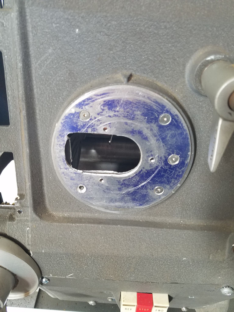

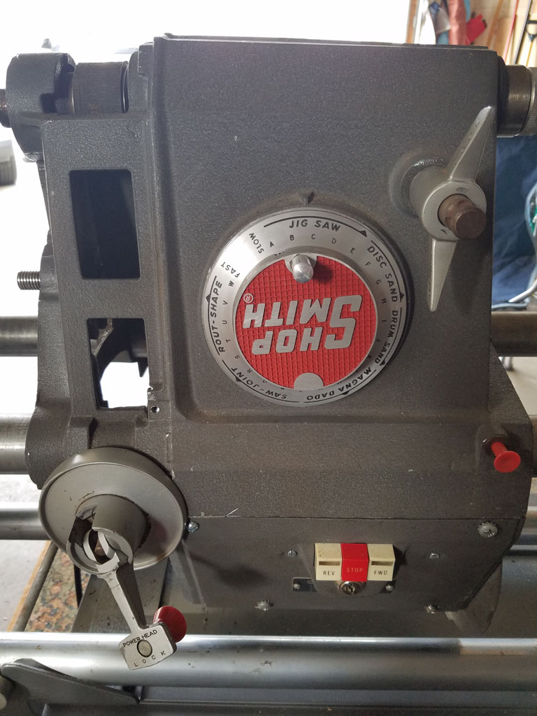

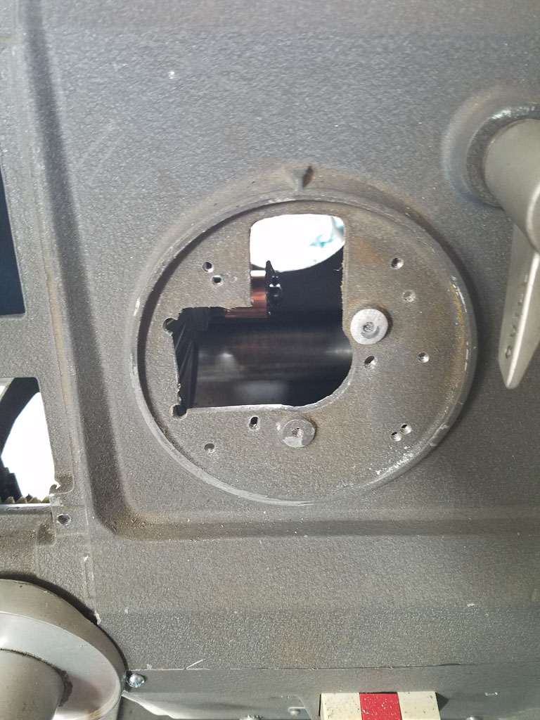

I looked closer at the removal of material from the headstock. They only removed two of the three mounting holes for the Mark VII speed control. So, I'm pretty sure I could come up with a fix for the third hole IF I need to go back to the Mark VII style controller.
I believe you're on to something with the Mark VII snout being shorter. That is probably why the quadrant assembly doesn't contact the control sheave in the right position. I think a longer snout would fix everything (or, as you mentioned move the speed control back towards the sheave).
JPG, I don't suppose you want to get in on this 'fun', and look into modifying one of your 'spare' MVIIs? This would be easier to collaborate on if I had someone else with a physical machine in front of them with the same changes.
I'm not really excited about moving the speed control because it looks good where it is. However, having it look good, but not WORK, isn't an option either! lol
I can't think of a good way to make the shaft/snout longer either. However, one idea I had was to make the quadrant assembly 'wider'. This would need testing, but in theory it could have the same effect as moving the whole speed control further back. I believe I could fabricate something relatively easily that would do this.
Here are some more pics that might help get a clearer picture of what everything looks like.

One more quick thing, I just realized that moving the speed control further back towards the sheave is not possible. It is already very close to making contact with the sheave. Any further in and it could hit as it spins. So, that is not an option.
EDIT:
I thought about widening the quadrant assembly, but that won't work either. The clip won't fit around the assembly if I widen it.
I COULD be over thinking everything, and maybe it works as is. The previous owner may not have oiled often enough, or maybe they did something that damaged the key. Perhaps if I replace the key, and the control sheave, everything will work perfectly.
That being said, in order to TEST that I will need to order those parts (I was going to do that tomorrow morning). If that does not fix it, I will have spent that money on parts I can't use.
I don't normally give up on these things, but my wife is probably getting tired of me spending so much time on it. So, I think I'm going to look into converting back to a Mark VII speed control. I will be more than happy to share as much info as I can with others if they intend to try this conversion. I think with enough brain power this conversion is doable, but I just don't have the time myself.
Thanks to everyone who tried to help (especially JPG). Hopefully someone else will take the reins on this and figure it out!
