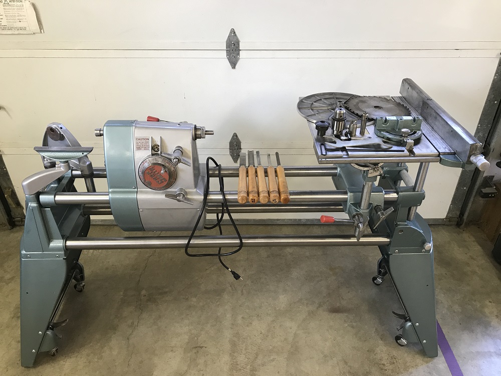

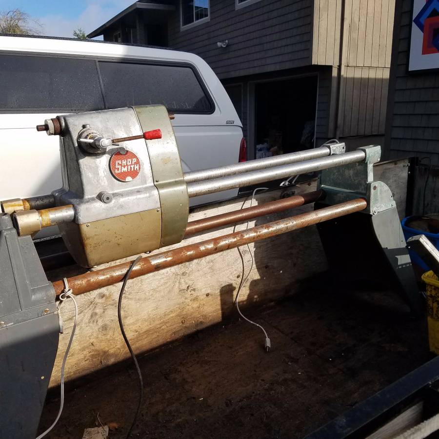

Below are before and after pictures of a Greenie I restored a couple of years ago.
picture from the craigslist ad
restoration completed
I have done the do it yourself PowerPro Upgrade and added the Double tilt to my 2001 Mark V 520. It wasn't a difficult task. Doing the Double Tilt Upgrade to a Mark 5 "Greenie" requires replacing the original 1-7/8" bench tubes with the later 1-3/4" Bench tubes. In 1960 the Bench Tube size was changed to match the Way Tube size of 1-3/4".
