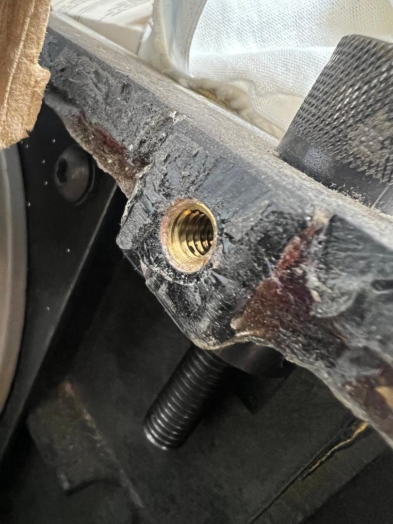

On my jointmatic, the knob threads into a brass insert molded into the slide. The gib is just a flat piece of steel, about 1/16 x 11/32 x ?. I would need to disassemble it to see how long the gib is, but it is at least 1/8" from the top of the slot. I don't think the size is critical, just something for the knob to apply pressure.

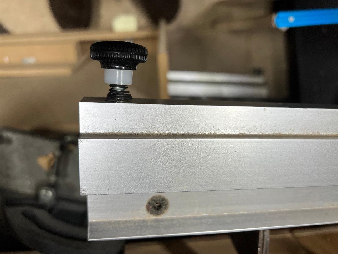

First let me clarify the use of the above mentioned fastener. I needed one and paid the $4.95 only to get a star type fastener, not like the version I had hoped to get. That star was not comfortable for me to use and well it didn't look like the others.....
I was able to find one with the same grip but they are a flat style. I then added a 1/4" spacer to give me what I wanted. You can see it here:
Now on to what JPG ask about. On mine it is a threaded insert:
Mine has been repaired but it looks like that part has not be affected so I believe it is original. Now there may be other vintages which are different??

Ed that explains he striations in the hole where mine is broken. That had me confused.
So threads in the slide. The knob/screw then presses against a flat piece that applies pressure to (likely both) the adjuster(top) and whatever the lower one is called.
I think that answers all I need to ask so a plan of action is forming.
