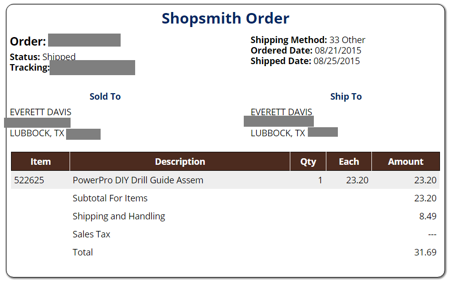

I bought one in 2015
It isn't listed for on-line ordering nor does it come up even today with the part number... but they have it, or can get it...
It is the metal piece, and the paper templates are 845628 and 845629 and the paper templates are available for on-line ordering.
Any headstock I refurbish, I pre-drill for a future PowerPro upgrade so it will be ready.
Here's a copy of my order FYI
Everett
Everett
